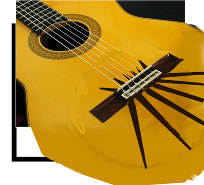

This guitar is for my own personal use, looks is not that important to me in this case. I don't think it would be ugly.
I'm not talking about the entire bracing being on the outside, more like an extension of the bridge. In a fan pattern that would be directly part of the bridge. I think it would give the bridge more stability as well. The inside would still have some bracing.
I think the bracing could probably be smoothed somewhat and not as tall to avoid hooking it.
Another idea I have is to have part of the bridge fit directly inside the soundboard, so the bracing inside is directly attached to the bridge. What I mean is the bridge would have to have a bit extra on the bottom (like a strip) that could extend into the sound board.
Thoughts?billb38562.9642476852

I was thinking if something like this.
